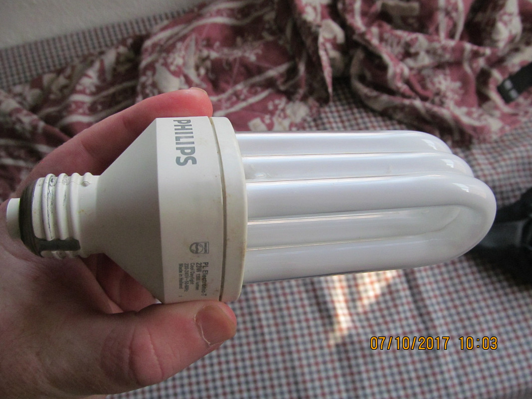

Rare Holland made Philips PL Electronic-T 23W cool daylight CFL, found at the succah of my hostel
Beside two generic CFLs that imported by Orot Amakim, I found this rare Holland made Philips PL Electronic-T 23W CFL.
This was the lamp that layed at the kitchen of my father former house, and lasted nearly forever (More than 10 years).

Update: This lamp is now in my room. But it is EOL probably, as it don't works at my computer/table lamp:

Are you sure its not just the plastic cap contacts not making proper connection, the electrodes don't look blackened.
Try it in a different socket just in case, also make sure the contacts of the lamp are free from corrosion, try rubbing them with sand paper if they are.

I tried to rise the contact of the base of my table lamp with a screwdriver, and it still won't work. It was also didn't worked at its original socket at the sukkah at my hostel, where I found it.

Get a plasma globe and try lighting it up that way Shame that a DAYLIGHT version of the parallel 3U Philips Electronic T lamp is gone EOL! I'd would have sold my blood to have one because the ones well what you see available are warm white and are hard to find (eBay)

Or with a SON-T ballast like 250W or lower try to resurrect it for a short time ( remove CFL ballast if possible)

Tried to light it with the plasma globe without any success. There was only a dim glow from the argon gas. I think that the ballast of the lamp is dead.

I think that the ballast of this lamp is dead, and that why it don't work even if the filament is intact.

It might light on a 18/20w choke with a starter, if you separated the tubes from the base, to get to the electrode wires, or a 18w/26w PL-C or 21w T5 electronic ballast
