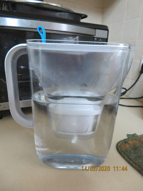

Re: Prolonging Kettle Life « Reply #13 on: March 14, 2020, 09:16:33 AM » Author: dor123
My mother, father and brother, all purifiers the water from fur with Brita jugs, having an active carbon filter that can be replaced, and boils the purified water in their kettles:
