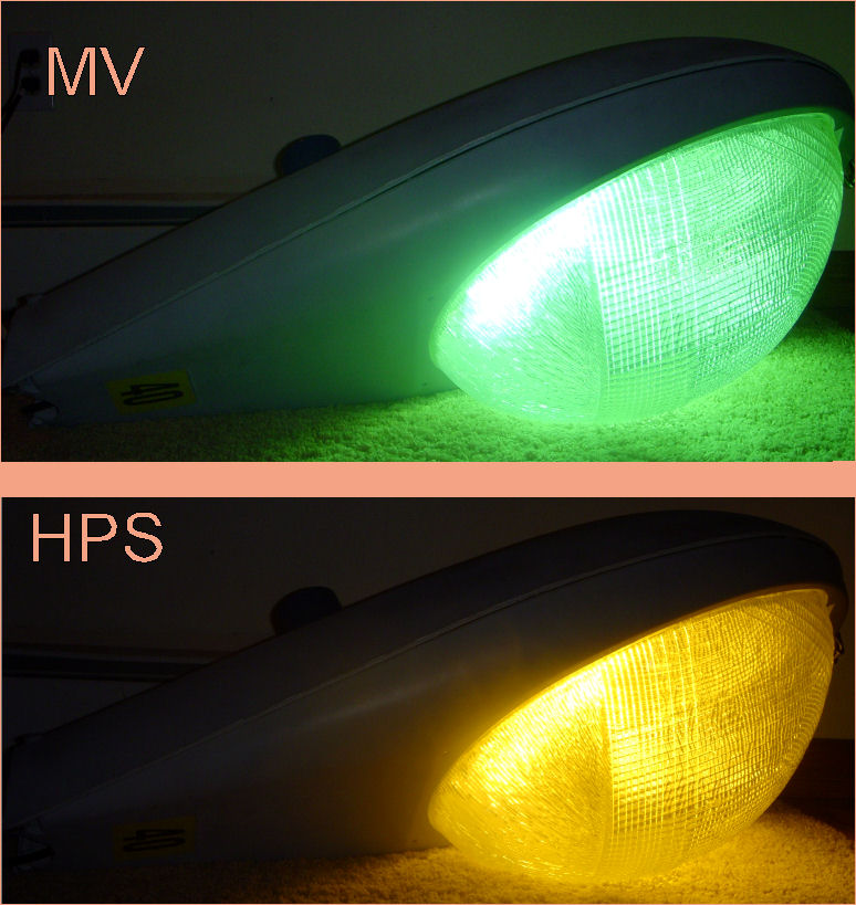

Well since i cant upload here, ill just post a message on the forums.
CLICK HERE FOR PICTURE
Well here are some Pros and COns of both
MV:
Pros:
Nicer color
Lasts Longer
Brighter than incandescent.
Cons:
Not very efficent, least efficient HID.
Lacks red light from spectrum
Less lumens per watt.
Now HPS:
Pros:
Very efficient
Lots of Lumens Per watt
Second brightest HID. (under LPS)
Cons:
Not good color,
Dosent last as long.
Also, under this kind of light, Its hard to deteer color.a
