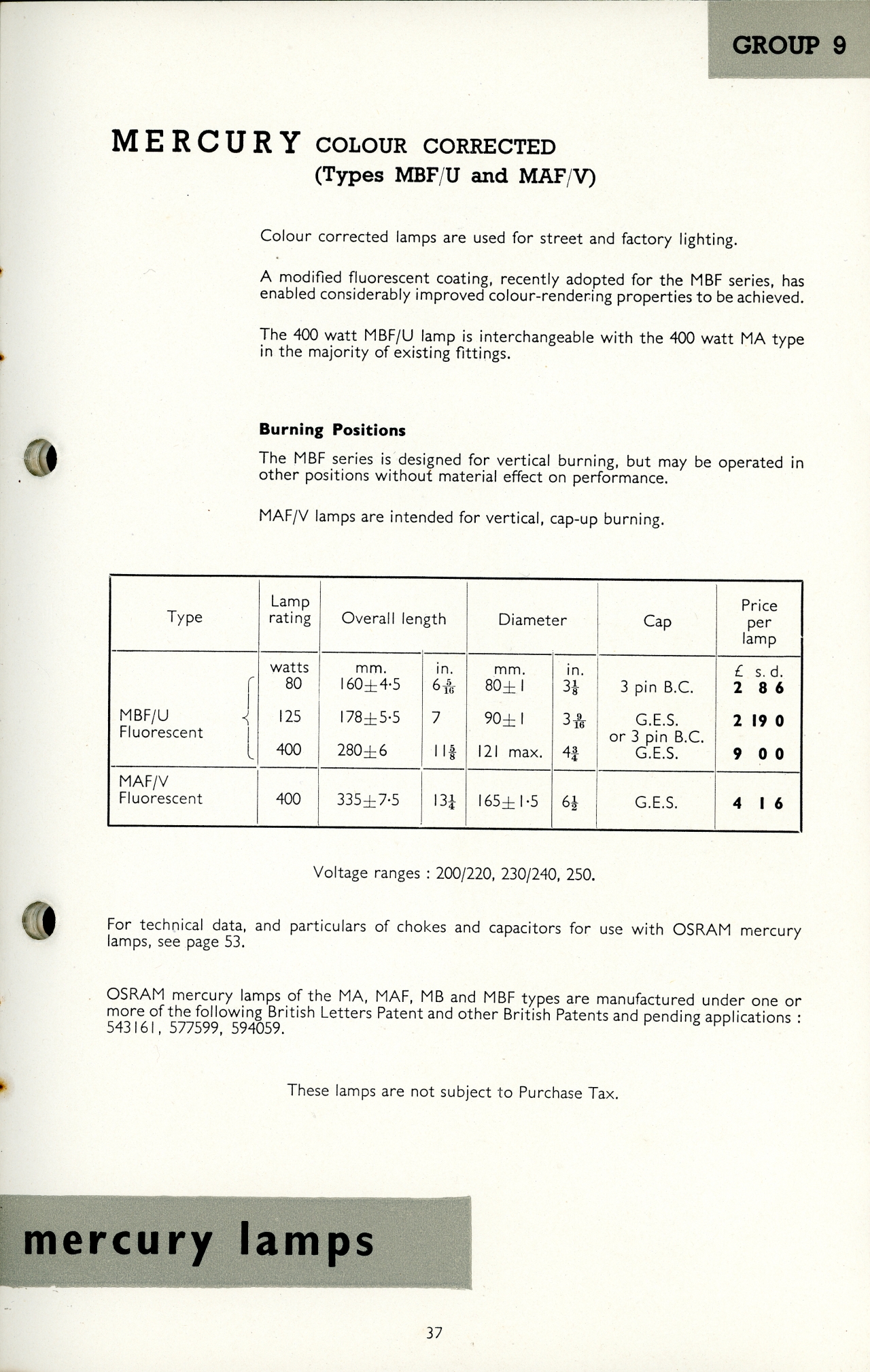

OSRAM GEC 400W MBF/U « Reply #6 on: December 25, 2022, 08:46:14 AM » Author: Olav
An addition from the OSRAM GEC catalogue, September 1956 edition:
Source: OSRAM GEC catalogue, September 1956, page 36
Source: OSRAM GEC catalogue, September 1956, page 37
