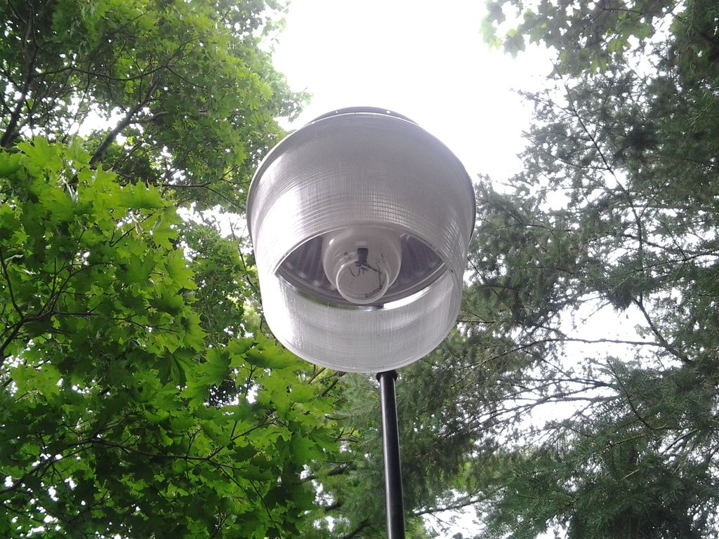

Hi there.
I would like to share my custom built or should I say modified Regent CBL25 Mercury Vapor yardlight. I removed the odd wattage 125w ballast and replaced it with a same brand and dimension  Regent 100w ballast and swapped out the medium base socket for a larger mougle base one. This required me to trim the refractor some to get it to fit.
I have my vintage Westinghouse BT-25 100w dx MV Lamp installed and it looks great at night. I will post a pic of it lit up.

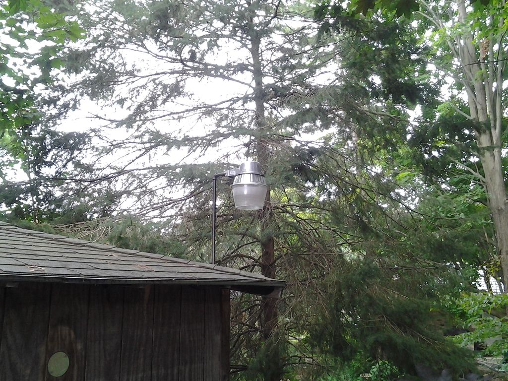

Re: My shed light. « Reply #1 on: July 29, 2015, 07:34:43 PM » Author: bucket175mv
Here is another pic.

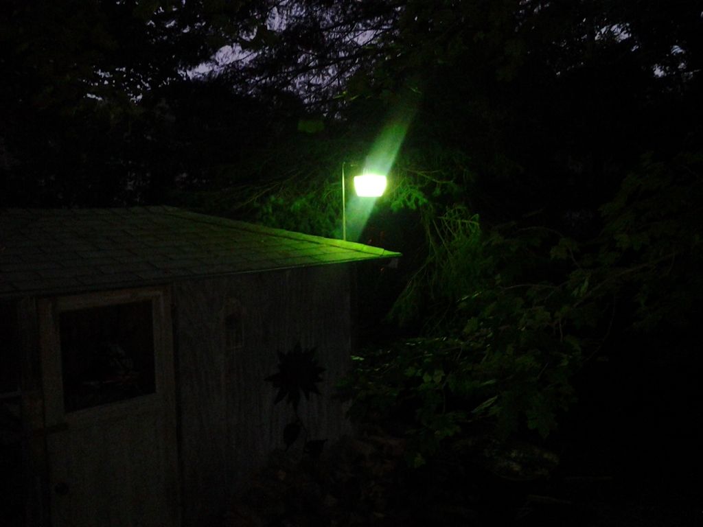

Re: My shed light. « Reply #6 on: July 30, 2015, 10:20:17 AM » Author: bucket175mv
Here is a night shot of my Shed light. Love the green glow from the Westie bulb.
Re: My shed light. « Reply #7 on: July 30, 2015, 03:37:17 PM » Author: Solanaceae
Nice. Can't beat the glow of a greened out  :mv: .
