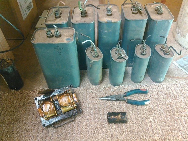

Here is another pic that shows the original capacitor from the ballast in the foreground, the rest of my pile of capacitors that were not being used to test the light (small cans are 10 and large cans are 55 mfd and yes they are old and most likely filled with PCB's, at least one has the number 1955 on it, though I'm not sure the they are that old so it may not be a date, It can be seen in the pic) Also shown is another small experament I did a while back, I have searched for a cheap way to re-seal/varnish transforers, so that is a H39 ballast out of a nema head. It has been varnished with Polyester resin. I could not find any info regarding the max operating temp after it had cured so I thought I would simply try it. I did two ballasts and have put a few hours on the one not shown and it seems to be holding up OK but more time will tell. I'll try to post it in it's own thread once I have ran it enough to find the result.

Are you sure the capacitance of your capacitors really is whats written on them ? Used capacitors may be a great deal off
