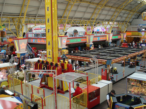

Have a look at this picture showing a seaside pier funfair decorated with neon lighting. Another picture from the outside shows the spectacular display of light created by loads of neon tubes all around the sides.
But unfortunately when lots of high voltage lighting is installed on an old wooden building it can cause illumination of a different kind - see here   :o
(That is the same place as the previous two pictures)
