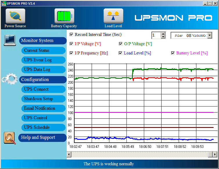

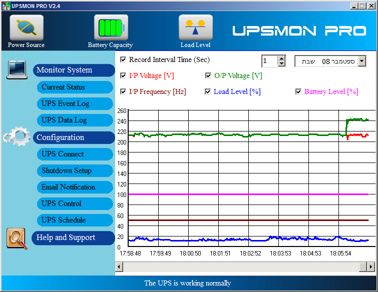

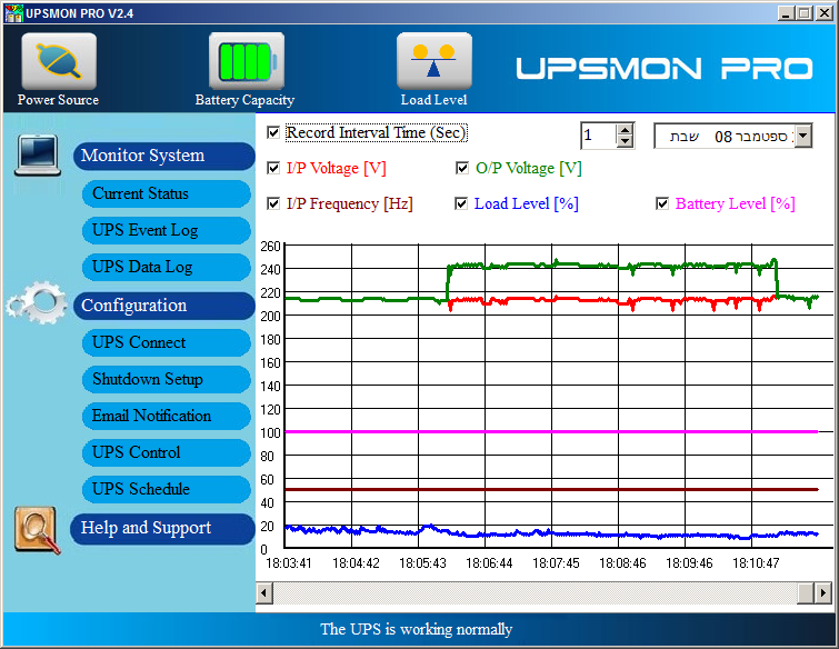

I opened my UPS monitor software to see what happening to the voltage in my room:
This don't happens in the rest part of the hostel.
Whats happening?
Update: This is happens in all of my hostel. I've noticed that the LED fixture in my hostel kitchen and the F6T5/BL of the bug-zapper, flickering as well.

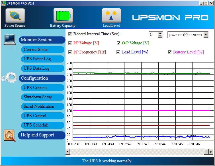

Voltage stabilized for now:
Also: It seems that this is a brownout, since I called 103 service of the Israeli Electric Corporation, and they said that there is a major electricity problem in my area.
