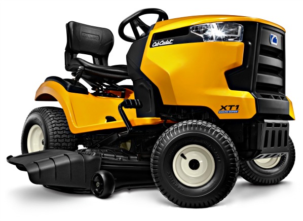

Re: Whats the point of having daytime running lights on newer cars? « Reply #8 on: February 24, 2019, 09:20:42 PM » Author: sol
I had a ride-on lawn mower with daytime lights. There was no switch either.
lightinglover8902
Power distributor: CenterPoint Energy. 120V 60Hz
GoL UCCuTTFLbXkZzWw1MEB7ro5Q
Re: Whats the point of having daytime running lights on newer cars? « Reply #9 on: February 24, 2019, 09:22:08 PM » Author: lightinglover8902
Wait....  Lawnmowers have them two?!?! :o

Re: Whats the point of having daytime running lights on newer cars? « Reply #11 on: February 24, 2019, 09:24:20 PM » Author: sol
Yes. In 2008 or 2009, Cub Cadet LTX series had them (incandescent). Not sure if they still do or not.
I got rid of this tractor last year, and it had one burnt out lamp and one working lamp. I never used it in the dark, so I never bothered to replace the lamp.

Re: Whats the point of having daytime running lights on newer cars? « Reply #12 on: February 24, 2019, 09:31:08 PM » Author: lightinglover8902
I think the newer Cubcadet mowers have LEDs now.
I think I did see one of these with LED lights on front at Home Depot.

Re: Whats the point of having daytime running lights on newer cars? « Reply #14 on: February 24, 2019, 09:44:47 PM » Author: sol
Well, in Canada, they have "LED High Illumination" headlights now. I assume they are daytime running. See here. I also assume the specs in the USA are very similar.
