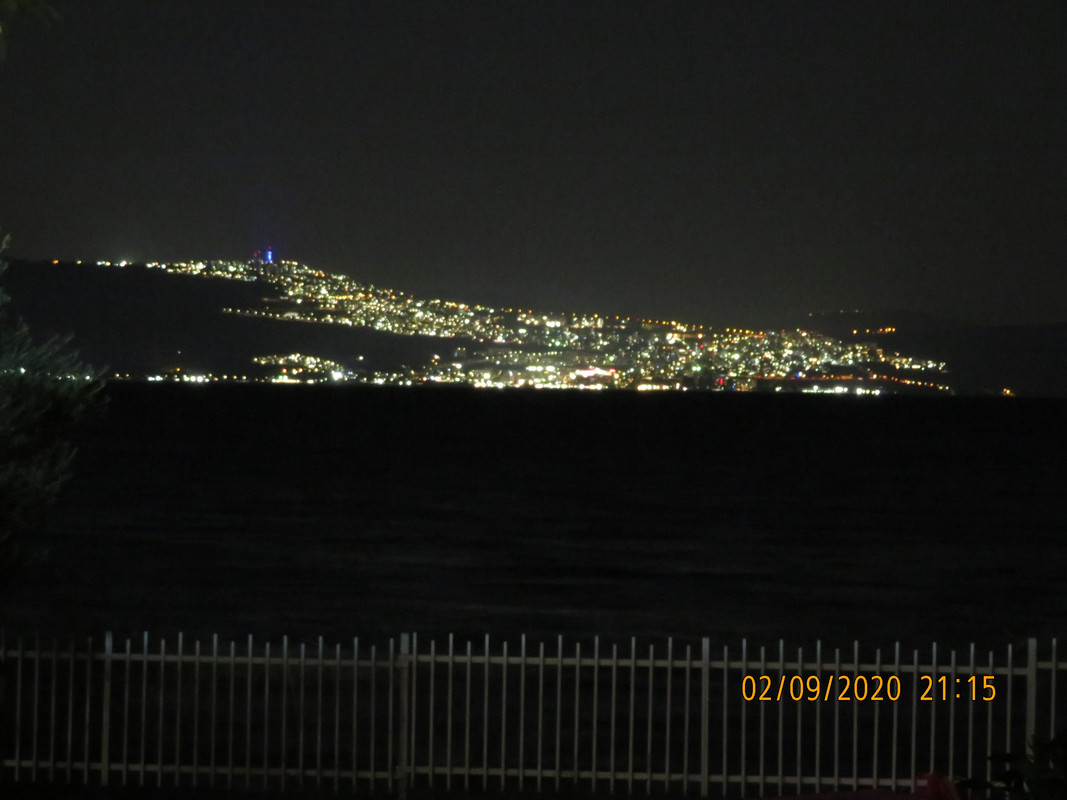

Re: Will the discontinuation of SOX lighting shutter astronomical observatories? « Reply #2 on: December 11, 2020, 06:45:57 AM » Author: dor123
Tiberias and lots of settlements in Israel, have much brighter skyglow, once they replaced their HID streetlighting to LED. See here:

Re: Will the discontinuation of SOX lighting shutter astronomical observatories? « Reply #3 on: December 11, 2020, 07:34:09 AM » Author: Binarix128
The problem is that LED doesn't have any beam control for make it cheaper, they are brighter than the original streetlights and irradiate in pretty much all the spectrum with wide peaks at blue and yellow wavelengths. With all that the observatory will significantly decrease its effectiveness and could become useless for some things. It could still be able to look object millions of light years away but it can't look for the object composition by the spectrum due to the high spectrum pollution, and it could easily give false results. Developing a filter to counter the LED spectrum would be expensive if not impossible, because of the wide spectrum there will always be a wavelength that could not be cancelled by any element.
It is like firing up an old spark radio that emmitt in all the spectrum near an airplane control, all their system will fail.
