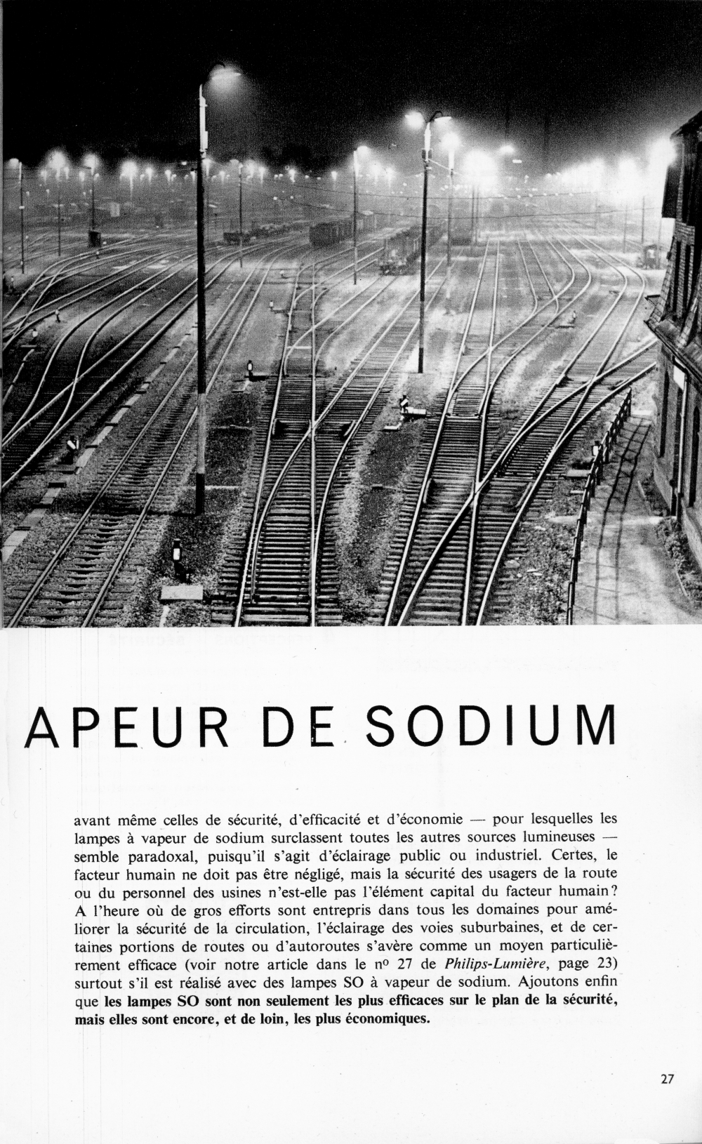

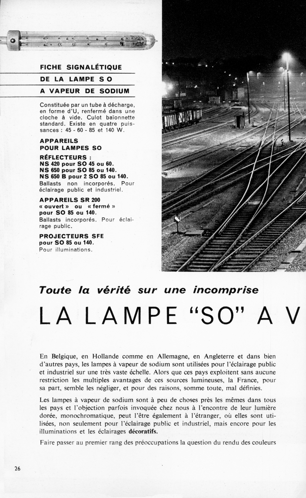

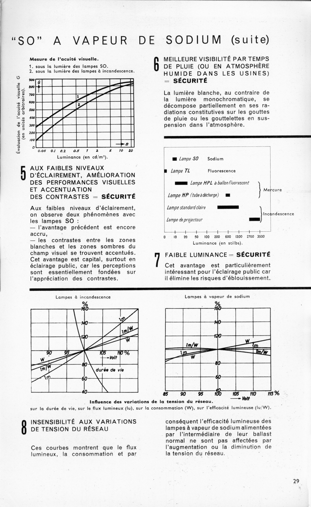

Here is a small excerpt from the magazine "Revue PHILIPS lumière" N° 28 from December 1958.
The small report shows the advantages of the SO lamps with tables and graphics.
Source: Revue PHILIPS lumière N° 28, Decembre 1958, page 26
Source: Revue PHILIPS lumière N° 28, Decembre 1958, page 27

Source: Revue PHILIPS lumière N° 28, Decembre 1958, page 29

Very interesting to read. I like especially where it states that visual acuity is best at about 5550 angstroms and that the monochromatic light from the SO lamps is the closest possible at 5890 angstroms. Also, the last page of arguments for the use of SO lamps have been discussed at length on various posts here (and make sense).
