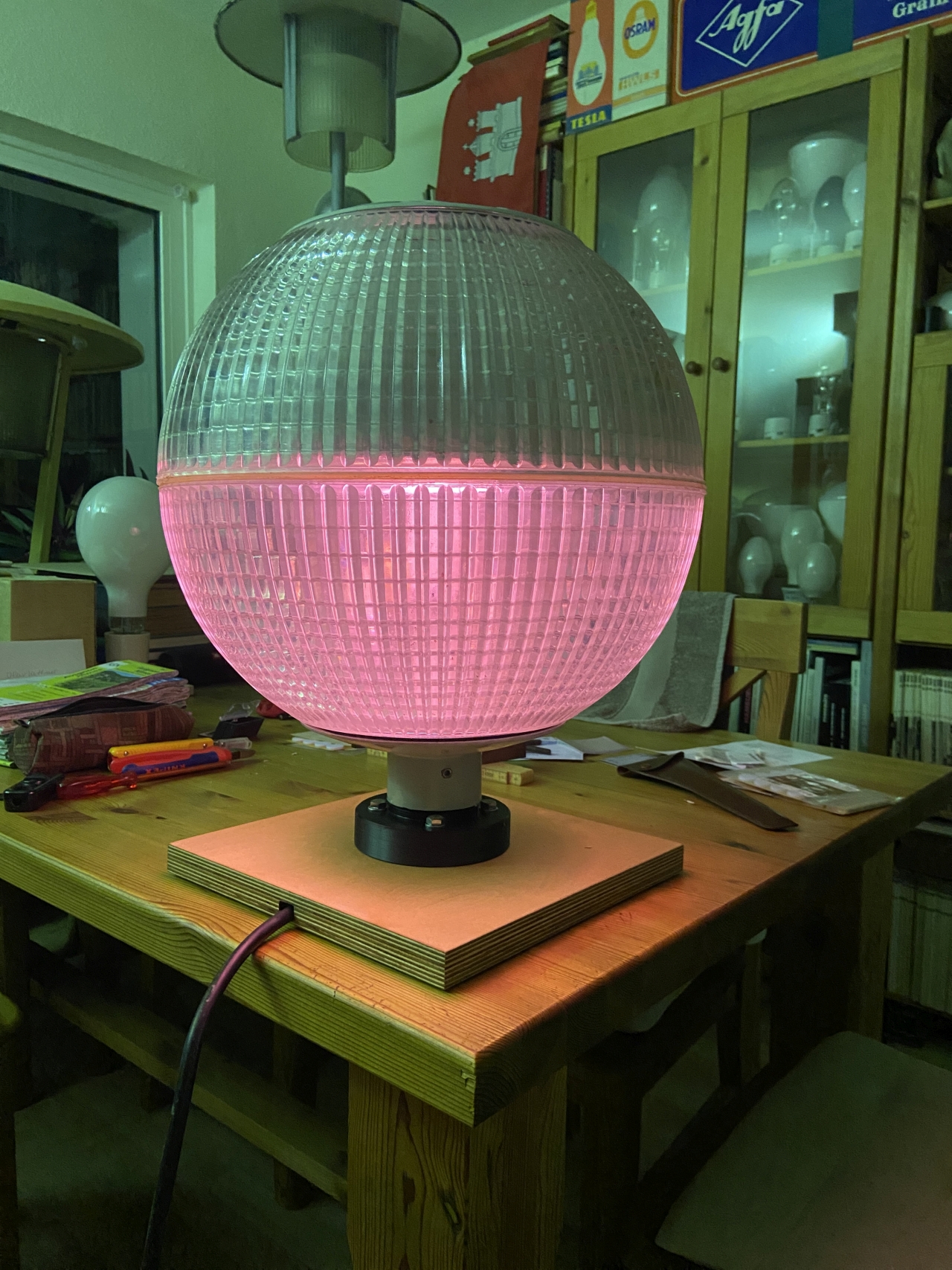

I made a turned part myself from black plastic material to hold the light. This was mounted on a wooden plate already prepared for this purpose. A channel for the connecting cable is milled into the wooden plate and 4 M8 drive-in nuts are fitted
in the holes on the underside of the wooden plate. The panel was made with drilling and milling by the joinery “around the corner”. The board also has 4 round felt elements in the corners on the underside. The sides and top were painted with wood oil.
I attached a round disk made of 4mm thick sheet aluminum to the upper part of the two threaded rods to protect the painted upper part from the direct radiant heat of the lamp.
So this is not original, but a modification. It works very well and the top cover on the light only gets luke warm even after several hours of use.
I installed a used ballast from OPTIMA for 80W and 125W high-pressure mercury vapor lamps. I abandoned the original plan to fit a 125W lamp, because it was already unpleasantly bright for the living room.
A PHILIPS HPL-N 80W lamp has now been installed, which is perfectly adequate for this purpose.
So you fiddle around with the part for weeks, painting, wiring, screwing, waiting for ordered spare parts (M8 cage nuts in this case) and “all of a sudden” the fixture is finished. As with many other projects,
you don't see all the time spent later on. In any case, I'm delighted with one of my new light sources in the living room.

Thank you Tim. It took about five years from the purchase of the fixture to this completion.
In between there was another flop, because I originally wanted to refurbish an older version of this fixture and had already started on it.
Unfortunately, it was not possible to separate the two half shells from each other. This would have been necessary to remove the inner reflector, which is made of sheet aluminum.

 Interesting ! The inner reflector is nice as it eliminates unwanted upward light . It'd be neat to see one without it also .
