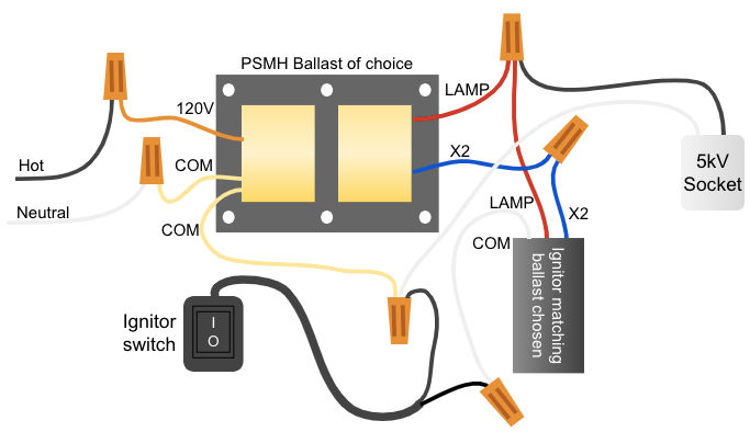

Wiring a switch on an ignitor common « on: May 30, 2025, 02:10:22 PM » Author: Maxim
Hi all,
I wanted to ask how I could follow through with one of @Multisubject 's designs. I want to run multiple lamps with one ballast, but a switchable ignitor.
I've never actually "seen" a switch in that part of a circuit- how does one go about doing that?
Thank you.

Anyway, with the ignitor thing. The plan drawing that I made a while back (I assume that is what you are talking about) was made for European-type ballasts, working with the weird ignitors they have over there. What materials do you have, and what specifically are your needs/lamps that you want to run? I will probably come up with a drawing of it for ya that explains it all.

Re: Wiring a switch on an ignitor common « Reply #2 on: May 30, 2025, 03:12:30 PM » Author: Maxim
@Multisubject - it was this.

Ahh I see, not the European one. So, you could use pretty much any mains-voltage switch, as there is very little current. Are you planning on putting this in a box, or mounting it on a wooden board?
If you want to make it on a board, I personally would use something like this:
12V-220V/10A SPST Paste Type Button Switch
This is rated at 220V 10A, which is a little low for an HID ballast, but considering that the load it will be breaking is derated down to 1A, I would completely trust this switch for use with this very small load. It is all enclosed with plastic, and keeps any live parts away form you, which is nice when you will be inevitably touching it.
So here is a drawing as promised:
Instead of connecting the "COM" wire of the ignitor directly to the "COM" of the ballast and lamp socket, it will go to one of the wires of the switch, with the other switch wire going to the "COM" of the ballast and lamp socket.
Let me know if you have any more questions regarding this!
