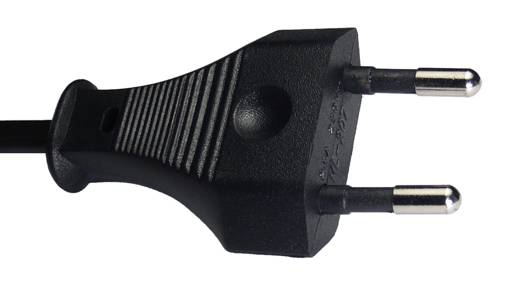

all european approved receptacle are made tamper safe, so it isn't an innovation.
also, phantom power can be eliminated with removal of recharger: if someone forget to remove it, it will forget also to press "UNplug" button.
Re: TGDaily - Boring electrical outlets revamped with Inlet « Reply #4 on: May 24, 2013, 07:16:19 AM » Author: Ash
I think they mean the shutter which is inside the socket, intended to preent the insertion of hairpins etc by kids. The half-isolated pins on plugs are part of hte plug design not the socket, so have nothing to do with the "new socket" presented above
In Israel (rougly based on early European standards, and developed on its own since) we have both the simple (insert hairpin get shock) and tamper proof ones, the simple ones being more common
The tamper resistant ones have their advantage and IMHO its not so much kids safety (kids have to be educated on not messing up with stuff, electrical sockets are just a tiny bit of the possible dangers - They could just as well poke the hairpin in the back of hte computer power supply etc and nothing would prevent it, or unscrew a ligtbulb from a desk lamp, etc etc and the only right thing to do is educate the kids that electrical devics are only to be used the correct way and not played with), but to protect the sockt itself in places contaminated by fine dust and with frequent plugging-unplugging (where a cover door won't last for long) - the shutter keep the 2 main contacts clean, so not prone to make a high resistance conection, and can prevent a few burned sockets and possibly fires
But the shutter have its own problems too, mostly : It catch on the wider section of pins of European plugs (like the one in the picture) and makes it hard time to pull the plug out. When the user tries to poull the plug out with force (and i seen a few such cases), this often end up either with the faceplate being ripped off the socket (exposing live contacts), or the socket pulled from the wall (yep some sparkies have no clue how to secure sockets in walls), and i seen a few cases where the user attempted to pull out a cheap USB charger, and you know how pathetic those are made, the charger break open, the cover in the user's hand, the circuit board hanging on 2 wires still attached to the plug base and plugged in. In a few other cases (with lower quality sockets) the shutter itself get stuck in the closed position rendering the socket useless
