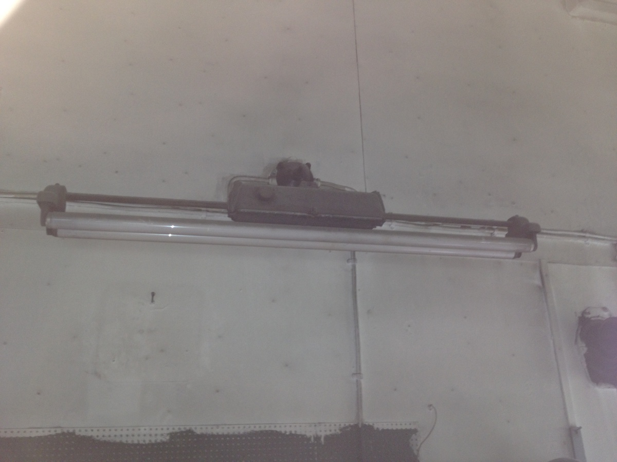

Does anyone know what kind of fixture this is? ???
Are these 40 watt bulbs?

It almost looks like one of those RF lights? If so, the tubes may be 5 feet long.

The tubes look quite ordinary T12 (in Europe I would guess for F65T12), I would expect preheat (the dimple on the ballast box appear to house a starter, second one I would expect on the other side)

One of the bulbs is EoL :)
