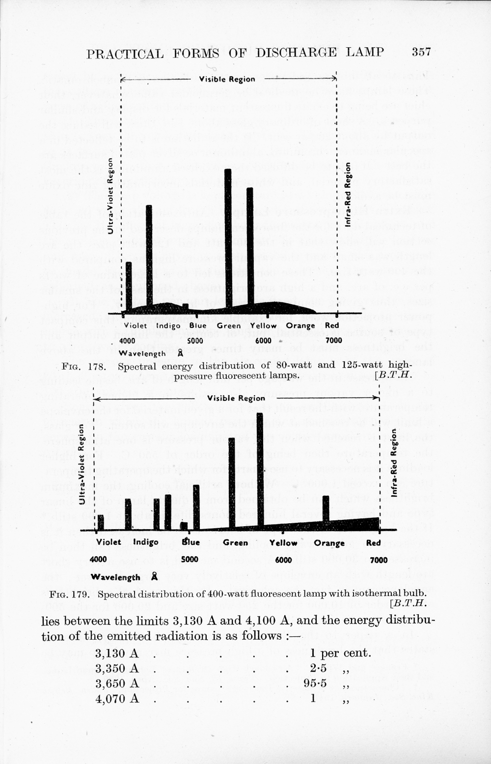

I am showing some text from a specialist book and a PHILIPS-catalog on an MV medium-pressure lamp with an isothermal bulb shape and phosphor.
Andy Oakley owns such a lamp. My wish is to see this photo here, too.
Source: PHILIPS-catalogue Australia, 50s
Source: ELECTRIC DISCHARGE LAMPS, by H. COTTON, LONDON 1946, CHAPMAN & HALL LTD.
I suspect this type was one of the first mv lamps with a phosphor.

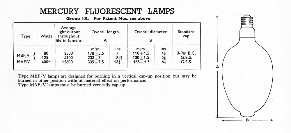

A small supplement of technical data.
The cutout is from the G.E.C. Catalog from 1951:
Source: G.E.C. Streetlighting Equipment catalog, London1951, page 85

I found a small addition to the lamp MAF/V 400W:
Source:
E.L.M.A.  ELECTRIC LAMPS, 1949, page 84 and 85,
Spottiswoode, Ballantyne Co. Ltd. London and Colchester

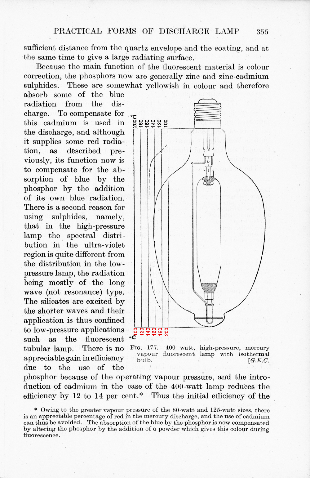

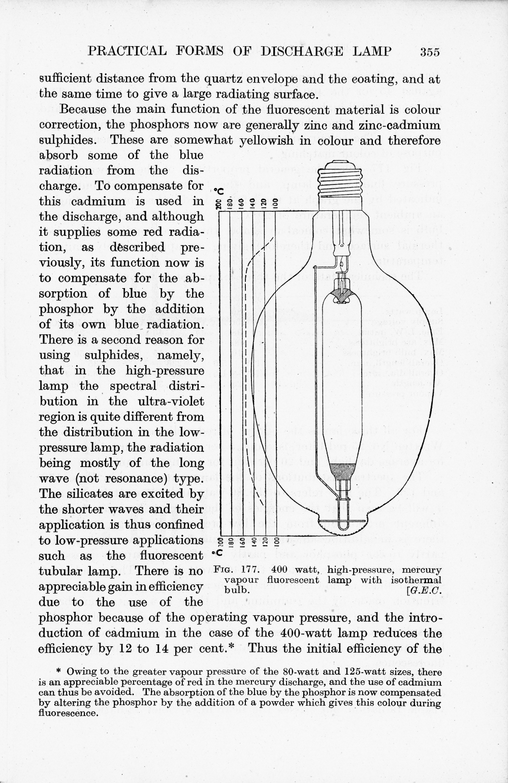

In the book "ELECTRIC DISCHARGE LAMPS, by H. COTTON, LONDON 1946, CHAPMAN & HALL LTD." printed in 1946 and in the book "Electric Lamps", issued by the lighting service bueau, ELMA, London, first printed in 1949, a graphic is made with information on the temperature at the outer bulb.
Apparently, an error was copied over and over again over the years without being noticed.
The fact is that the temperature is highest in the inner center (the arc tube) of a discharge lamp and decreases towards the outside.
However, the graph shows exactly the opposite.
To emphasize this, I have left the original temperature information in black type and inserted the corrected temperature information in red type.
I would be interested in your views and opinions on this.

Re: Reading: mv medium pressure lamp with isothermal outer bulb shape « Reply #9 on: April 28, 2023, 05:46:38 PM » Author: James
This is an interesting consideration, but I do think the original may be more correct.  It would not be logical at the lower end that the temperature increases when moving further downwards, and closer towards the relatively cold lower end of the arc tube.
The primary heating mechanism of the glass of such lamps is absorption of radiation.  The absorbed photons are decelerated and increase the phonon energy in the glass (ie heat).  We can see this, because even the outerbulbs of vacuum lamps like HPS and certain metal halide types become intensely heated during operation even though there is no gasfilling for conducted or convected heat loss.  Glass is quite transparent to visible light and shortwave IR-A, but a strong absorber/reflector of longer wavelength IR-C as radiated by the hot arc tube.
However, due to the gasfill of low pressure air/nitrogen in this lamp, I would expect the cap area to become rather hotter than the minimum temperature indicated in this drawing.  Beyond the lower temperature of 100C labelled at the shoulder of the bulb, I would expect temperatures to rise again towards the neck.  Perhaps I should bring a thermal imaging camera or snake-eye type thermometer next time when visiting Andy to learn more about the energy balance in these fascinating old lamps!
Re: Reading: mv medium pressure lamp with isothermal outer bulb shape « Reply #10 on: April 29, 2023, 12:39:08 AM » Author: Olav
Thank you James for your very interesting explanation. It would be very nice, if it were possible to use a thermal imaging camera.
I've learned something new, for that I thank you.
