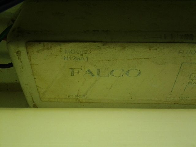

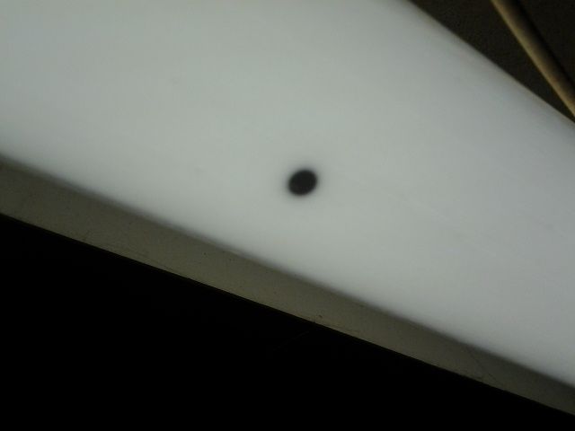

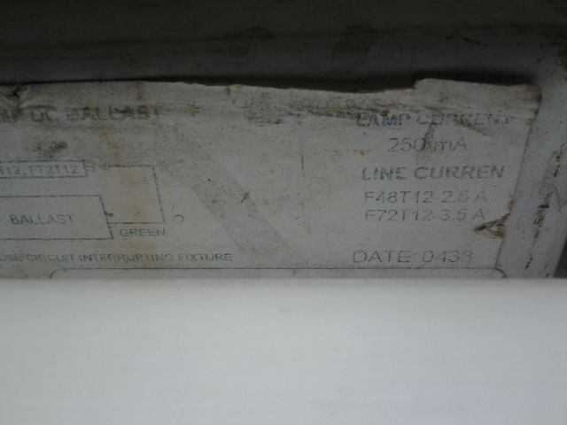

Here some pictures as promised.
I just install NOS F72T12 55W and it lit up fine with DC ballast.  Quite large drop size mercury in Norelco tube
