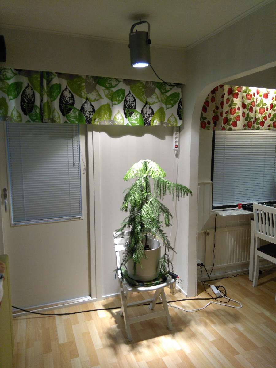

Re: Plant light, MH or MV? « Reply #5 on: September 16, 2017, 11:48:43 AM » Author: Roi_hartmann
Alright, thanks for the advices. Here is the end result. This particular plant locates here in the winter time. Fixture is Lival MH spotlight with 70w Philips CDM-T 830 lamp and magnetic ballast. Now I just need a neater extension cord and a timer. This particular spotlight is very good since it has narrow beamwide so it lights only what is needed.
Lodge
Re: Plant light, MH or MV? « Reply #6 on: September 16, 2017, 07:46:17 PM » Author: Lodge
Looks good, the tree will be happy in no time..
Re: Plant light, MH or MV? « Reply #7 on: September 17, 2017, 12:32:17 AM » Author: tolivac
The spotlight looks nice-yes-the plant will love it!-along with the humans.I use ceramic metal halide plant lights for reg lighting-love the warm white color-3100K.
