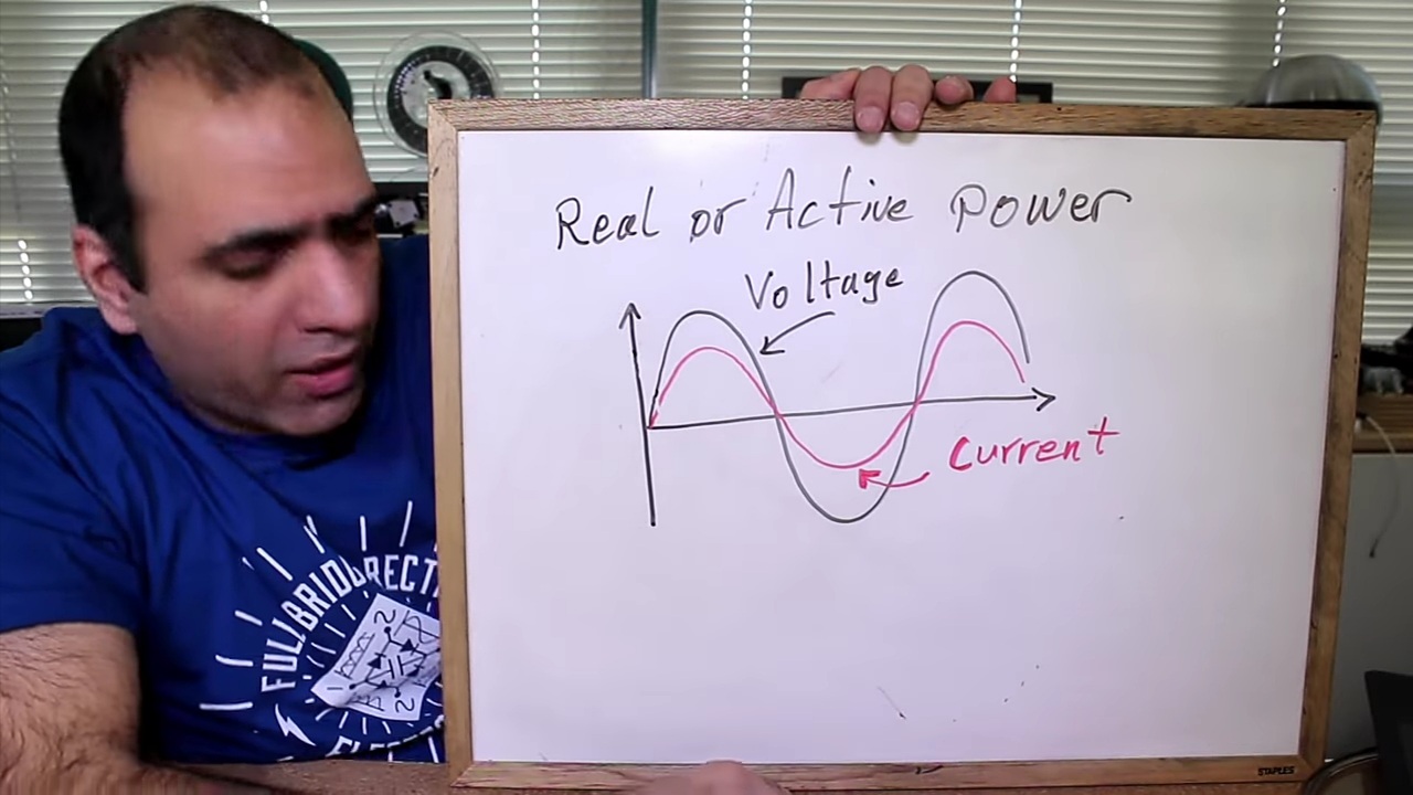

Re: Is this ballast a CWA ballast? « Reply #11 on: November 24, 2020, 07:47:32 AM » Author: Binarix128
How can I determine if the phase is capacitive or inductive?
You can determine the type of load by looking at the oscilloscope waveform. A normal power meter with a power factor indication may work, and you can do the experiments at full voltage and without extra transformer.
The capacitive load lags the current and tend to have a power factor of 0, the inductive load leads the current but I don't know its power factor.
The previous pictures are from this video.
Re: Is this ballast a CWA ballast? « Reply #12 on: November 24, 2020, 04:30:33 PM » Author: Medved
@Binarix128: You've found very nice pictures for that...
