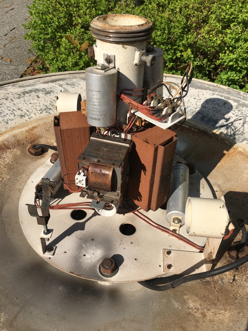

some manufacturers have made this combinated types.
In the 50s and 60s very popular lantern in Germany: "the chinese-hat" (Chinesenhut).
The picture above shows two mv-ballasts and two autoleak-transformers
Biggest version was made with 4 lamps mv 250W and 4 lamps lps 140W.

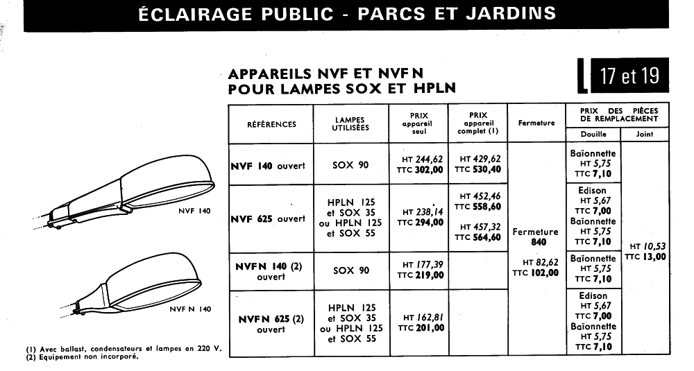

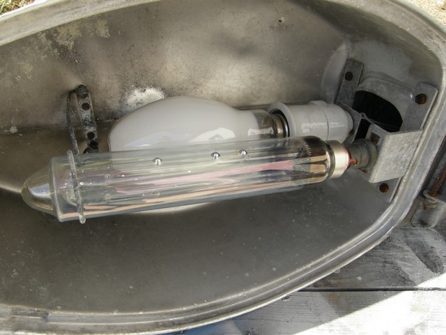

here is another example from PHILIPS with combinated mv lamp and sox lamp, the type NVF N 625 and NVF N 625 :
Source: PHOZAGORA
Source: PHILIPS éclairage, barème 1969 - édition mars

Looks simple enough to make one of these (which I have never seen before!).   :lps: :mvc:

The use of both MV and LPS in the same lantern, is to save energy by turning off the mercury lamp at midnight. If you want white light from this combination, than only HPS and MV.
