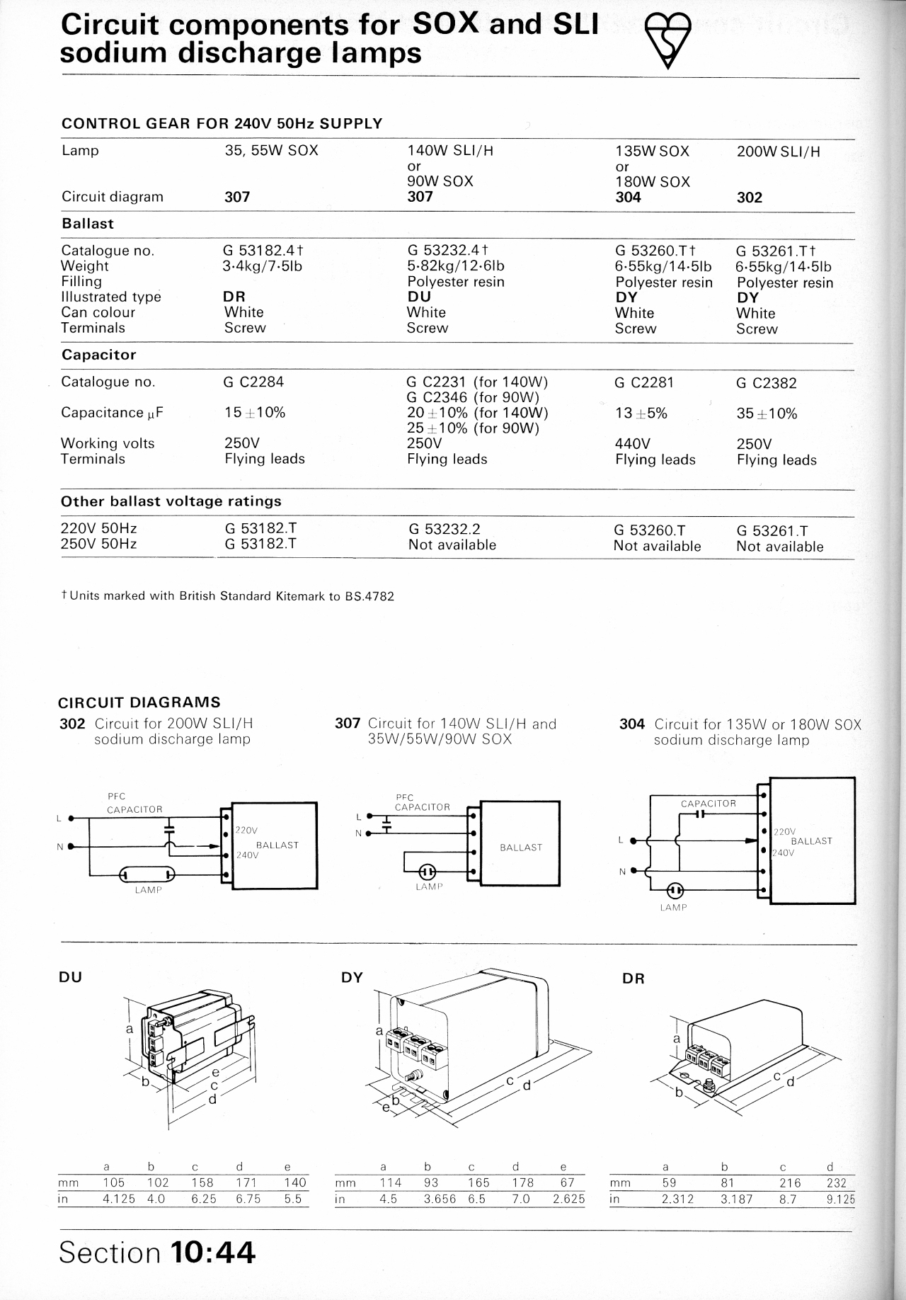

Re: Thorn 200W SLI/H High Output Lamp Leak Transformer Pictures And Information « Reply #6 on: November 24, 2022, 06:54:00 PM » Author: Olav
Hello Bob,
a difficult search.
I only have this information for you from 1973/1974.
That looks very modern for the time.
Maybe it helps anyway.
Source: THORN LIGHTING, Comprehensive Catalogue 1973/74

Re: Thorn 200W SLI/H High Output Lamp Leak Transformer Pictures And Information « Reply #7 on: November 27, 2022, 04:12:35 PM » Author: Bush DAC90A
Thanks very much Olav a big help kind regards bob
