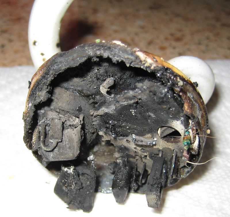

Anyway, I'm posting this here because the ranch was the site of the (in)famous "Air Raid Sirens forum CFL fire" which got spread around the Internet. The lamp in question which exploded in flames was a Lights Of America 23 watt Mini Soft White spiral.

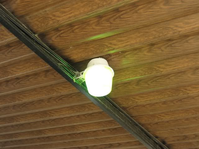

Anyway, after getting back to the barn when we were done picking the fruits, I asked  his wife about the light which burned up and she pointed me to the end of the barn where it happened. The fixture that was damaged in the fire had since been replaced but I was told there were several of the same fixtures inside the barn.
Could anyone guess what may have been done ?
I feel that the bulb which caught fire had accidentally been powered with a 100 watt Mercury Vapor ballast.

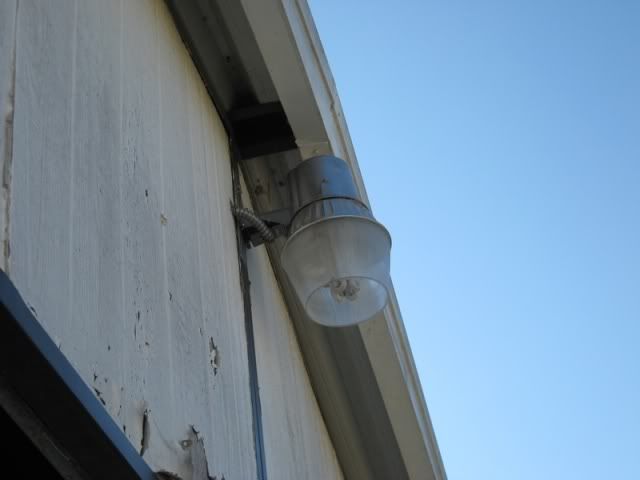

This is what replaced the burned fixture outside the barn door.
These are from the facts I got from his wife. If I can get a hold of Charles when he isn't busy, I'll try to verify the type of fixture.

That might be a cause. The ballast get more then twice the rated voltage (MV ballast OCV is in range 220..350V, depend on the exact type). As the current from the MV ballast is limited, it did not trip the fuse, but keep dissipating excessive power in the CFL ballast...
By the way i've seen CFL's offered as retrofit for MV. I don't know, if these use their own ballast (designed for the 200..350V input) or simply (preheater) fluorescents made to match MV characeristics (mainly rated operating current).
