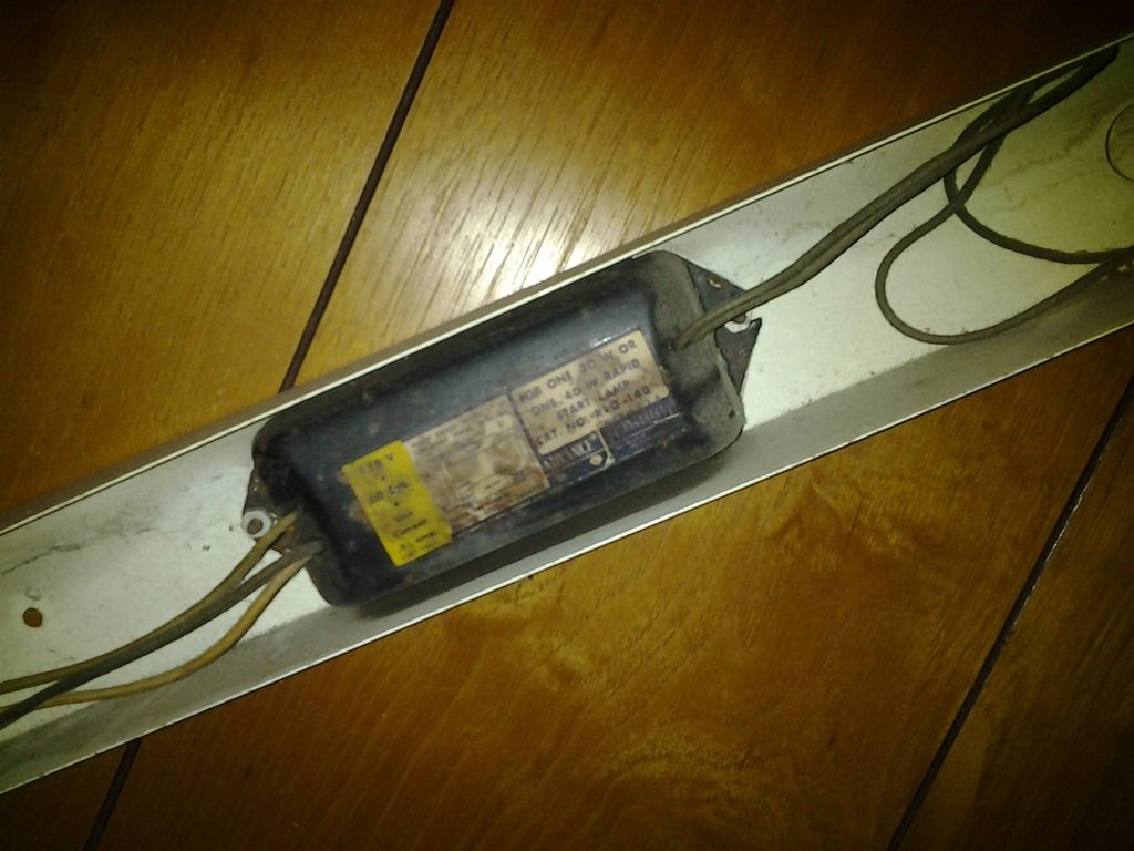

I have an old fluorescent F40 Single lamp black light fixture that has a rapid start 30/40w ballast, could I use this? It has a lable saying line current=.93A and its old lol.
Re: 50w Mercury Lamp operation. « Reply #29 on: July 29, 2015, 02:00:25 PM » Author: Medved
The line curent does not tell much, important is the secondary lamp arc current.
Because rated for both 30 and 40W, the arc current would be somewhere below 0.35A (both F30 and F40 have the same arc voltage of 108V, so present the same load for the ballast), so way too low for the MV lamp, it would operate on just barely 30W even in the most optimistic case when assuming the full mercury dose eaporates. In reality it would be even lower due to the lower arc voltage.
A "full power" F40 ballast operates at 0.43A, that means about 36W to the MV: With horizontal burning position it used to be barely sufficient to fully evaporate the mercury (the gravity pulls the mercury from the colder electrode area to the warmer center section, so it is able to overcome the low arc voltage, so low power saturated vapor state), with vertical burning it still makes troubles (the mercury pool resides in the colder electrode area, so it get stuck in the saturated vapor mode).
You may try it, but when the 0.43A was already marginal, I would be skeptical about any success...
Normally the MV couldbe dimmed in such way, but it should be operated on the full power the first 15 minutes after ignition to ensure it warms up and so fully evaporates the mercury dose. But that would need some means of (initial) lamp power boost just for the lamp warmup (second ballast of the same type, initially conected parallel and disconnected by timer or an arc voltage detector, when the arc voltage exceeds about 70V).
