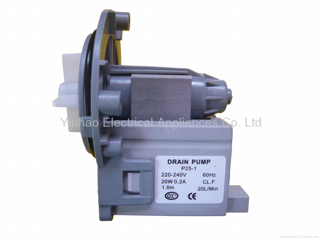

Some examples I have found o Google (practically the same concept with many makers):
http://img.diytrade.com/smimg/491180/23296046-1527778-0/Drain_Pump_for_Washine_Machine/1eaf.jpg
https://www.google.com/imgres?imgurl=http://www.isplc2006.org/b2b/pics/Drain_Pump.jpg&imgrefurl=http://www.isplc2006.org/b2b/paraffin/3/&h=359&w=359&tbnid=0le0R_sQL_qz-M:&docid=Z9pMBVw6IIBWZM&ei=sG_UVpS1KMe2eImwr5AN&tbm=isch&ved=0ahUKEwiUzYWqsJ3LAhVHGx4KHQnYC9IQMwhHKBYwFg
http://img.hisupplier.com/var/userImages/old/balla/balla$7258529.jpg
http://www.hooverspares.co.uk/file/efACmSO/fb5f2dc4-f03e-4698-abdd-6058a7f8bb1b.jpg
The ferrite permanent magnet rotor is in the "wet" part together with the impeller (just on a simple stainless steel pin as the bearing, lubricated by the water itself). The rotor assembly is essentially just the ferrite cylinder, with plastic injected into it's hole forming the bearing and with many including directly the impeller blades, with some the impeller wheel is loosely coupled so the rotor may rotate freely about 180degrees till it takes the impeller with it (for more reliable starting, to eliminate the water drag for the first magnet start)
Around the rotor is a sealed plastic tube enclosing the "wet" part and separate it from the "dry" part, then around the tube is the core of the stator electromagnet (and obviously it is on the "dry" side...).
You may see practically all pumps depicted in these Google search results show essentially the same concept among all of the make and models...
« Last Edit: February 29, 2016, 11:40:06 AM by Medved » Logged
