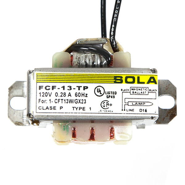

That makes perfect sense now in regards to voltage drop across the capacitor and power factor! :) Last 2 questions- and I'm sure its obvious but I am not a fluorescent expert... where do I find the rated current for any particular bulb? Can I just take the current off an equivalent magnetic choke and assume that as being correct?
https://5fc98fa113f6897cea53-06dfa63be377ed632ae798753ae0fb3f.ssl.cf2.rackcdn.com/product_images/files/000/094/769/legacy_product_detail_large/data?1431466985
And I notice that when 13 watt US lamps are driven its always with a 120 volt source, however as long as I size the capacitor to maintain 30-40 operating volts, I should be fine with a 240 volt source?

You could take the rating off a Magnetic ballast or sometimes from the manufacturer's specs. Few manufacturers have a concentrated datasheet with various lamp data
The general rule (which can be broken sometimes) is, that to run a lamp with a choke you need a voltage source approximately double the voltage of the lamp, or higher. So the lamps with ~40..60V arc (up to 9W PL-S, 18W PL-L, 18W T8, 20W T12) can work with a choke at atleast 120V, while the lamps with ~95..110V arc (11W PL-S, most PL-C/PL-L/2D, 36..58W T8, 40..80W T12) can work with a choke at atleast 230V. Any lamp can work with a choke at higher voltages (choek value will be different)
The US 13W will need a suitable choke to work on 240V. I think 2 of the 13W 120V chokes in series may be close enough. you can likely also add a 2nd 13W PL in series i.e. run 2 PL 13W + 2 chokes all in series on 240V
