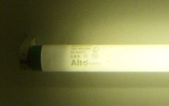

KEDER
Re: The illustrious Ballast Killers- Phillips Alto! « Reply #33 on: October 11, 2009, 10:20:56 PM » Author: KEDER
At walmart in evergreen, they have tons of ALTOS in the lights. here is a pic of one:
http://www.disasterous.org/alto.jpg
