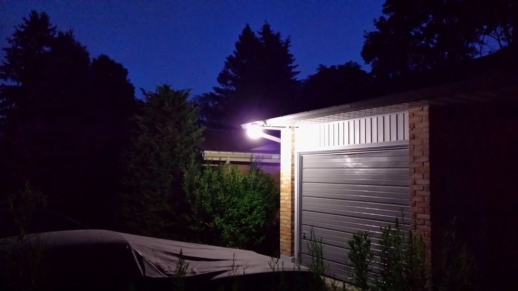

Thanks Solanaceae. My goal was to create something that looked like it was factory made and to have a HID Mercury fixture that was suitable for residential use. I'm somewhat frustrated though, the light output from this 50w MV bulb and 35/39 watt ballast combo emits almost as much light as a 100w MV set up like it was originally :/ Any ideas? What I now need is a dim high hour greened out 50 watt :mv:lamp!
Here is a few night time shots.
Re: Custom 50 watt MV mini bucket fixture. « Reply #7 on: July 16, 2016, 02:22:44 PM » Author: Medved
Well, that is to be expected with the MV - it is just not that efficient light source. And if you want some greened out, it will be even less light.
Re: Custom 50 watt MV mini bucket fixture. « Reply #8 on: July 16, 2016, 02:25:40 PM » Author: Ash
Isnt the problem here opposite, the lamp is too efficient ?
Re: Custom 50 watt MV mini bucket fixture. « Reply #9 on: July 16, 2016, 03:04:29 PM » Author: AngryHorse
Stunning job mate, look really well, with that slight hint of red in the light. ;)

Re: Custom 50 watt MV mini bucket fixture. « Reply #10 on: July 16, 2016, 04:38:26 PM » Author: bucket175mv
Exactly! It seems to be just as bright as my 100w version but only consuming roughly half the power.
