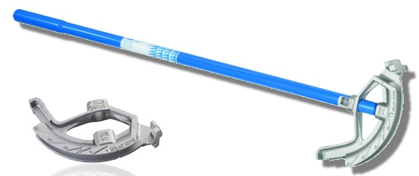

You'll need this tool and a LOT of muscle! What you have is rigid conduit. I've done 1/2" rigid and it was hard. Can't imagine 1" one.
That or borrow/rent a powered conduit bender from an electrician in your area.

Yeah, I find bending pipe with just a torch tends to kink the pipe at the bend so I would either use the conduit bender (powered if available) or use a bending spring if you have to use a torch to bend.
A muffler shop should have a powered pipe bender that might be able to bend that pipe if you can't find a conduit bender
