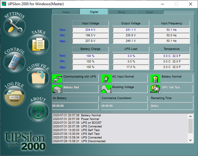

Update: The voltage went down to 200V in my hostel now, and my Osram/Ledvance LED filament lamp vibrates in brightness.
Re: Voltage variating between 220, 230 and 240 heree. « Reply #23 on: July 31, 2020, 02:31:19 PM » Author: dor123
