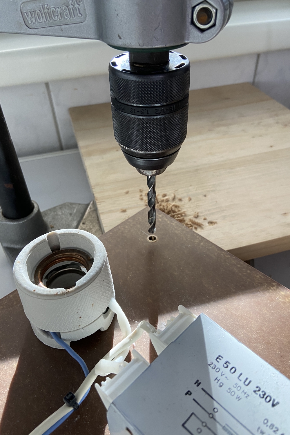

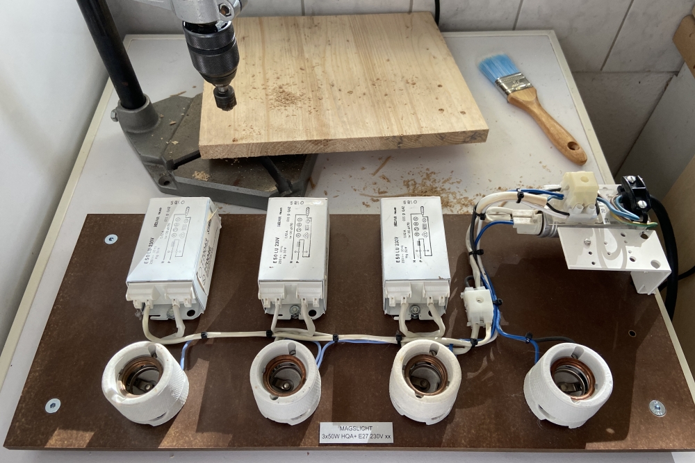

I am currently doing the rest of the work on the test boards that magslight has been very diligent in building for all of me.
The little rubber "feet" were still missing, so that the test boards can stand up well and the table doesn't get scratched by all the nuts and bolts sticking out on the underside.
It is a work that is "invisible" later. It's done and no longer noticeable. It's not fun when you have to do it at home, but the work pays off.
So I always do one thing after the other and drill the holes and then build in the countersunk screws with the rubber foot and a nut.
Re: What did you do today lighting wise? « Reply #1237 on: October 17, 2022, 04:35:35 PM » Author: Mandolin Girl
Nice construction work, I wish we had the space in our flat to have a pillar drill.  8)
Re: What did you do today lighting wise? « Reply #1238 on: October 17, 2022, 06:30:24 PM » Author: Olav
It's all improvised. The small drill press is on top of the washing machine in my kitchen. There is little space.

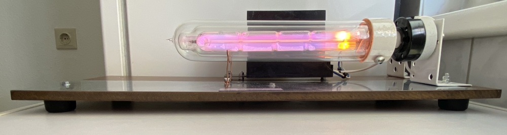

Another picture here from the next completed test board.
Here you can see the "feet" made of black rubber.
An oldie was allowed to do the first test run today.
Re: What did you do today lighting wise? « Reply #1240 on: October 18, 2022, 10:50:27 AM » Author: Rommie
60W "Bamboo" lamp, nice one, love the colour of the start-up on these, due to the Xe-Ne-He fill  :lps: 8)
We used to make boards like that, but we found it easier to separate the ballast from the lamp, in order that lamps that require specific burning positions could be accommodated, so we now have the lamps themselves held in laboratory retort stands and plugging into a socket on the ballast board:
Re: What did you do today lighting wise? « Reply #1241 on: October 18, 2022, 12:40:49 PM » Author: Olav
This is a good solution.
Starting with 90W LPS, it makes sense to make a division:
- one plate for the gear
- one plate (or alternative bracket) for the lamp.
That's my plan, too.
